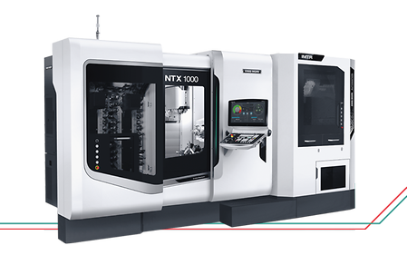

The perfect robotic automation for the NTX
  • Loading and unloading by robot
  • NTX 500
    • Robot max. transfer weight: 7 kg  (reference max. weight of workpiece per hand: 2 kg)
    • max. workpiece diameter: Φ70 mm
    • max. workpiece length: 65 mm
  • NTX 1000
    • Robot max. transfer weight: 12 kg (FANUC), 10 kg (KUKA) (reference max. weight of workpiece per hand: 2 kg)
    • max. workpiece length: 100 mm

Technical data
Max. workpiece weight kg
Max. workpiece size mm
Capacity
Tray size mm
IMTR
7.5 (Single hand) / 2.25 (Double hand)
ø 100 * (Max. length mainly limited by max. workpiece weight)
543 × 343 (Internal dimension) *
Machine
NLX 2500 | 750 2nd Gen.
NTX 500
NTX 1000
IMTR
● available * Drawer type stocker
