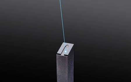

5-axis laser precision machine for complex prototypes as well as special processing
made of carbide, powder-metal steels, ceramics and other advanced materials.
  • Linear drives with acceleration > 1 g
  • Highly dynamic torque motors in both rotary axes (B- and C-axis)
  • Compact machine design with only 4 m² footprint
Best machine features for high-end machining
  • Tunable laser source with variable pulse length and burst modes
  • High positioning accuracy of ≤ 8 μm
  • CCD camera and 3D measuring probe for fast setup
3D laser ablation for the production of miniature molds, extrusion dies, inscriptions and engravings
  • Contact-free machining without need of electrodes and without tool wear
  • Highest repeatability and reproducability
  • Machining of standard materials up to Advanced materials like glass, ceramics and tungsten carbide
  • Surface qualities up to Ra < 0,1 µm in carbide tools
