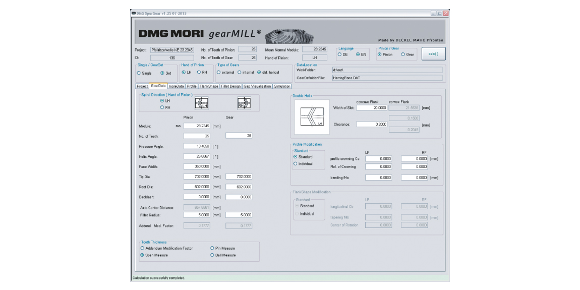

Simple creation of the NC program
Simple creation of the NC program by entering the gear parameters. CAM programming, post processors and simulation of the NC program.

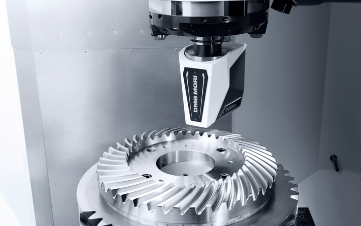

In-process measuring
In-process measuring, tactile using a measuring probe and NEW: optically using a laser scanner – accuracy similar to that of a coordinate machine.

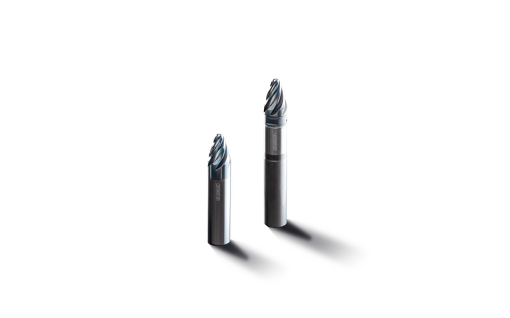

    DMQP
    Horn
    • Solid carbide tools and interchangeable insert systems
    • Version with optional coolant supply
    • Tools for all module sizes
