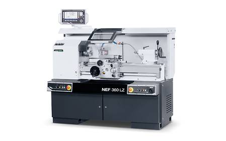

NEF 360 LZ
Ideal for training and conventional manufacturing
NEF 360 LZ
  • Powerful center lathe in toolmaker accuracy in accordance with DIN 8605
  • Equipment that is universally deployable in any workshop
  • Infinitely variable speed and feed entry via the DMG MORI position display
  • Intuitive operation
  • Main spindle bearing with belt pull relief for highest precision
  • Comprehensive range of safety equipment
  • High-quality apron with drop worm
  • Made in Germany​​​​​​​
