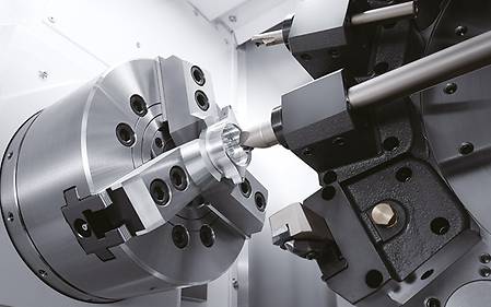

Process integration
  • Largest number of tools in the class: 18 tools
  • Integrated machining in the smallest floor space
  • Proven experience in diverse machining, from round to irregular workpieces
Super-high precision
  • Thermal displacement (at cold start): ø 4.0 μm Circularity: 0.8 μm
  • Adoption of a pre-tension structure suppresses thermal displacement and realizes high positioning accuracy
  • Stable machining accuracy thanks to stainless steel covers
High rigidity
  • The horizontal, single-piece, scraped cast iron slideways with superior damping performance and a high resistance to chatter facilitate stable machining
  • Minimized distance between the axis travel reference guide and spindle restricts effects of generated heat
