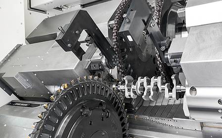

Three tool carriers for shortest unit times - turning and milling on one machine
  • Powerful milling units with direct drive and 3,000 Nm torque
  • Additional turning unit with 42 cutting inserts and 195 mm X-stroke for every requirement
  • OP 20 and OP 30 on one machine: Up to 50% time reduction in the production of main bearings and bearing pins
Integrated steady rest in the turning unit
  • Integrated self-centering steady rest incl. clamping range monitoring and fine adjustment
  • Appropriate for all crank shafts Ø 35-80 mm
  • Patented concept
