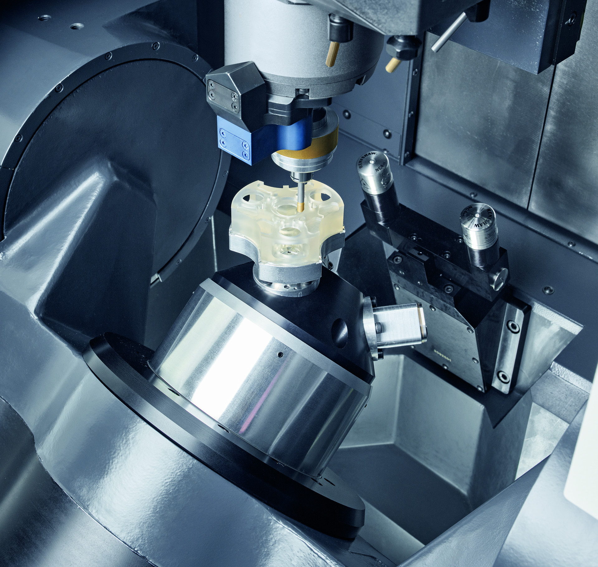

With the ULTRASONIC technology developed in collaboration with SAUER, DMG MORI has for many years now been offering high-performance machine tools for the high-precision 5-axis machining of complex workpieces made of advanced materials. The series has now entered a new league with the new 2nd generation ULTRASONIC 20 linear. Extensive optimizations across the board, from the expanded ULTRASONIC technology and the machine construction, the performance and on to include the options available, further enhance the technical edge of the machining center. Spindle speeds of optionally up to 60,000 rpm, more powerful drive motors, an even smaller footprint plus CELOS with apps developed specifically for ULTRASONIC are among the innovations that users from the optical, clock and watch, medical and high-precision mold construction sectors will benefit in future.
Reduced process forces for filigree structures, surface qualities up to Ra < 0.1 µ and longer tool service life
The decisive technological innovations of the ULTRASONIC 20 linear  2nd generation include a new, completely digitally controlled ultrasonic generator plus ULTRASONIC actuators with enhanced performance.
The decisive technological innovations of the 2nd generation ULTRASONIC 20 linear include a new, completely digitally controlled ultrasonic generator plus ULTRASONIC actuators with enhanced performance. The tool holders with adapted actuator technology are changed into the milling spindle simply and automatically. Each of these holders contains so-called piezo elements, which are activated by a program-controlled inductive system with a high frequency of between 20 and 50 kHz. The actual tool rotation is thus superimposed with an additional tool movement in the longitudinal direction so that a defined amplitude, which can be programed in the NC-program, in the range of up to more than 10 µm is generated on the cutting edge of the tool or on the grinding layer. During grinding, drilling and milling this ULTRASONIC superimposition of vibrations has a direct, positive impact on process forces, metal removal performance and tool service life and thus on the machining result in the form of cost efficiency and accuracy.
Intelligent ULTRASONIC technology for process-compliant amplitudes
“MT-option” for outer- / inner cylindrical grinding: the ULTRASONIC 20 linear enables complete machining of rotation symmetrical workpieces with grinding and drilling incl. inner- / peripheral machining in only one clamping.
More exactly ULTRASONIC results in a higher removal rate, accurate edge machining and up to 40 percent reduced process forces in the machining of advanced materials such as glass, ceramics, corundum, composite materials and hard metal. Deflections are minimised while workpiece accuracy and process reliability are increased. In addition, this oscillating contact interruption results in better lubrication and cooling of the cutting edge as well as optimum removal of particles from the active zone. This enables longer tool service life as well as excellent surface qualities of up to Ra < 0.1 µ for hard-brittle high-performance materials. The 2nd generation ULTRASONIC 20 linear thus uniquely combines high speed cutting and highly efficient ULTRASONIC grinding of advanced materials on one machine. It allows the machining of an unrivalled broad range of materials.

The smartSONIC is used in the 2nd generation ULTRASONIC 20 linear as a new ULTRASONIC generator. This automatically recognizes the ULTRASONIC frequency that is best suited for actuator and tool. As another world first it also tracks the frequency and amplitude power during the machining process. To achieve this the smartSONIC automatically tracks the frequency response and compensates all external impacts, such as damping of the ULTRASONIC vibrations caused by the prevailing process forces. This results in consistent control of the set amplitude or that defined in the NC-program. So the user can maximize his process to the utmost and thus increase tool utilization, minimize cycle times and most especially achieve even more filigree, accurate and high-quality manufacturing results thanks to the reduction of process forces.
DMG MORI relies on the long-term stable gantry design for the 2nd generation ULTRASONIC 20 linear in order to meet the demands on precision for ultrasonic machining. Whereby the machine tool manufacturer was able to reduce the footprint to a compact 37.7 ft². A duel drive in the Y-axis and the integral cooling concept that includes temperature monitoring of drives and spindles as well as the control cabinet and all media guarantee top precision and component accuracy. The linear scales from Magnescale are another example of the high-tech components used by DMG MORI here.
