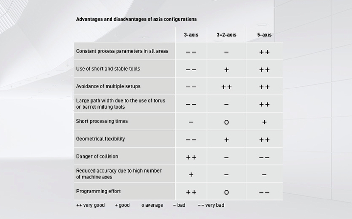

One of the greatest advantages of a 5-axis machine is the ability to produce complex workpieces and precise components in mostly just one setup, with less time and lower costs. As a result of this degree of freedom, 5-axis simultaneous machining can be used to produce virtually any workpiece contour in a single operation without reclamping. This saves unproductive idle time and also avoids inaccuracies when changing from one machine to the next. In addition, the tool can always be perfectly positioned relative to the workpiece. This ensures that tools in shorter standard lengths can be used. This in turn increases rigidity, enables higher feed rates and extends tool life.
Advantages and disadvantages of different axis configurations (Graphic: DMG MORI | Source: "Successful Milling in Toolmaking", Study Fraunhofer IPT 2018, p. 15)
